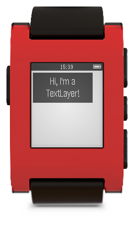

TextLayer
Layer that displays and formats a text string.
The geometric information (bounds, frame) of the Layer is used as the "box" in which the text is drawn. The TextLayer also has a number of other properties that influence how the text is drawn. Most important of these properties are: a pointer to the string to draw itself, the font, the text color, the background color of the layer, the overflow mode and alignment of the text inside the layer.
