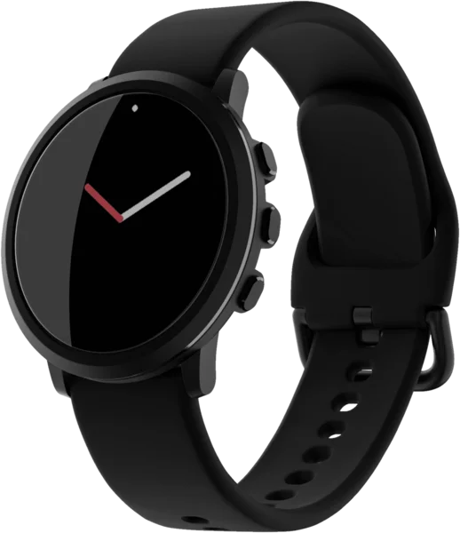

Pebble Round 2 (getafix)
Overview
Pebble Round 2
Board:
getafix
Revisions:
dvt, dvt2
SoC:
SiFli SF32LB52
Platform:
Gabbro
Emulator:
qemu_gabbro
Pebble Round 2 is a round color watch with a touchscreen, built around the SiFli SF32LB52. Its firmware targets the Gabbro platform, which apps see as a 260 × 260 round color display.
Hardware
  • SoC: SiFli SF32LB52, with an Arm STAR-MC1 (Armv8-M) application core with FPU, a Bluetooth Low Energy controller on its own core, and 512 KiB SRAM
  • Flash: GigaDevice GD25Q256E, 32 MiB NOR
  • Display: 260 × 260, 64-color round JDI memory-in-pixel, driven by the SF32LB52 LCD controller
  • Backlight: Awinic AW9364E LED driver
  • Touch: Hynitron CST816 capacitive touch controller
  • Accelerometer: ST LIS2DW12
  • Magnetometer: MEMSIC MMC5603NJ
  • Ambient light: W1160
  • Vibration: Awinic AW86225 haptic driver (dvt2), or Awinic AW8623X (dvt), with a linear resonant actuator
  • Microphone: PDM, on the SF32LB52 PDM interface
  • Power: Nordic nPM1300 PMIC and battery charger
