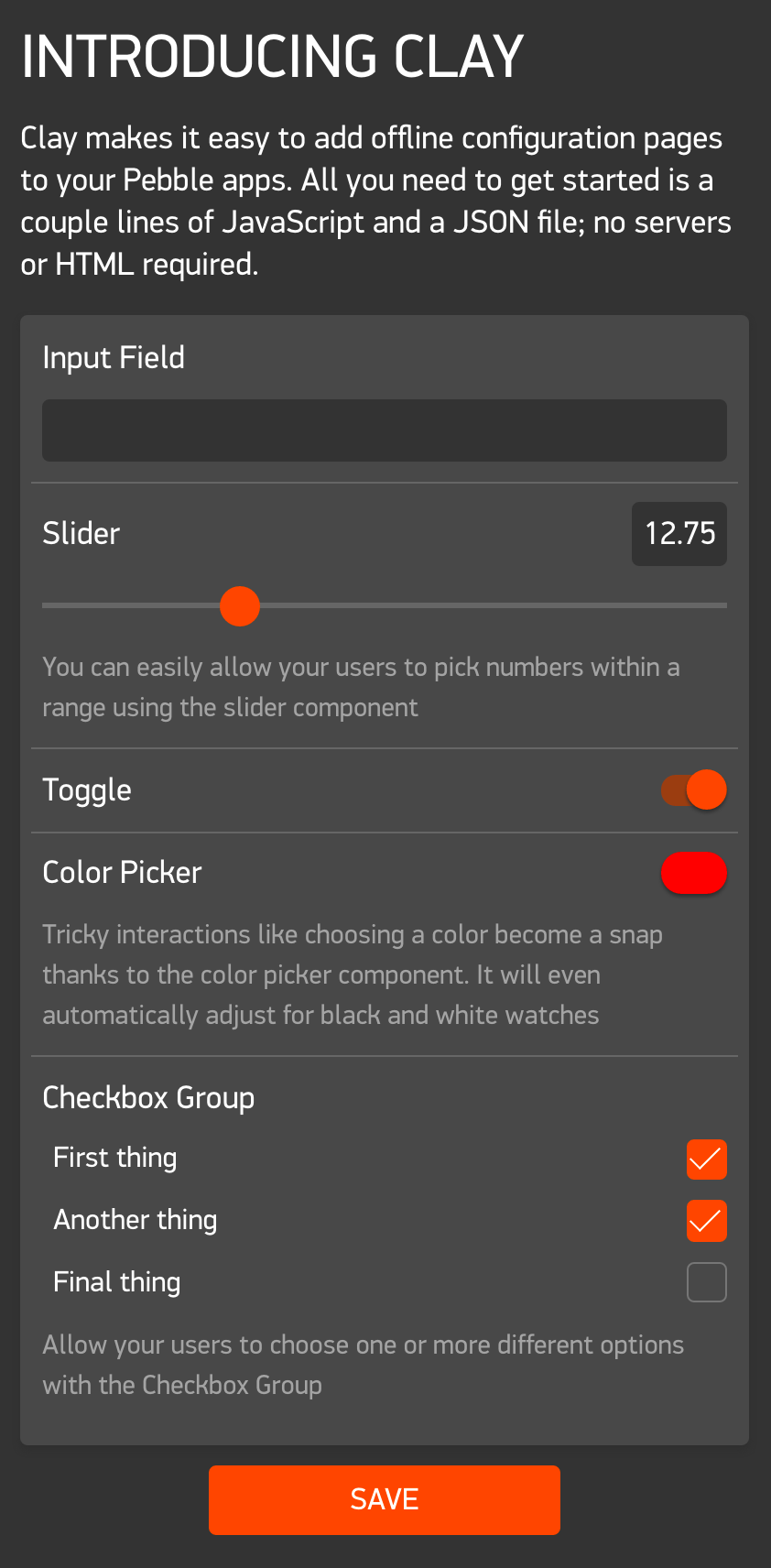

It is with great pleasure that I present to you, Clay, a Pebble package that makes it easy to add offline configuration pages to your Pebble apps. All you need to get started is a couple lines of JavaScript and a JSON file; no servers, HTML or CSS required.
Clay Example
How to get started
This post aims to provide high level explanation of how the framework works and how it came to be. Below is a quick overview of how easy it is to make your app configurable with Clay. If you would like to learn how to integrate Clay into your project, read our guide on app configuration or read the full documentation on the project GitHub repository.
1) Install the module via Pebble Packages - SDK: $ pebble package install pebble-clay - CloudPebble: Add pebble-clay, version ^1.0.0 to your project dependencies.
2) Create a configuration file that looks something like:
module.exports = [
    "type": "heading",
    "defaultValue": "Example App"
    "type": "section",
    "items": [
        "type": "color",
        "messageKey": "BackgroundColor",
        "defaultValue": "0x000000",
        "label": "Background Color"
        "type": "toggle",
        "messageKey": "Animations",
        "label": "Enable Animations",
        "defaultValue": false
    "type": "submit",
    "defaultValue": "Save Settings"
3) Update your project settings with the matching messageKeys from the config above.
4) Add a few lines to your index.js
var Clay = require('pebble-clay');
var clayConfig = require('./config');
var clay = new Clay(clayConfig);
5) Retrieve the values on the C side using standard app messages or alternatively let enamel do the work for you.
