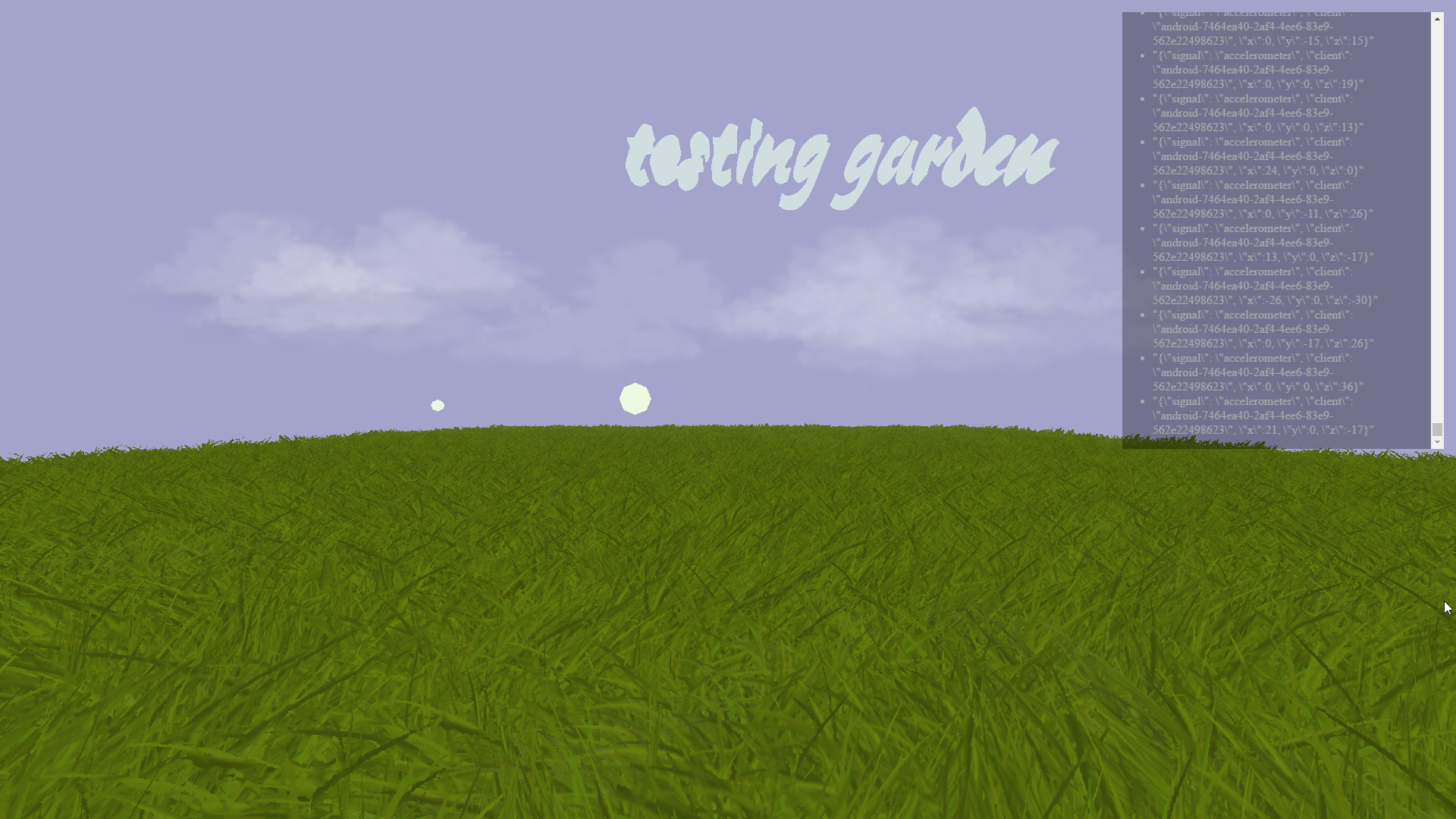

Work has begun on expanding the project. The web app design makes it trivial to connect multiple users all playing separate instruments, enabling multi-user performances with each participant playing remotely from anywhere in the world. The viewer end of the interface is modeled as a visualization of a garden, with viewers represented as flowers in the garden and performers as bouncing balls of light. Viewers can chat through a common interface, help shape the current performance through their interaction, as well as record, play back, and share performances.
Test Interface
Garden's demo interface
Development has begun on a new instrument interface powered by an Android application. The app works similarly to the interface created for the Pebble - streaming sensor data from the phone to the web app, with additional concerns and design changes due to the weight of the phone and the addition of a touch screen. The differences in the two will make for two distinctly different instruments with similarly intuitive styles of control, enabling users to join together for collaborative, physically-based musical performances.
