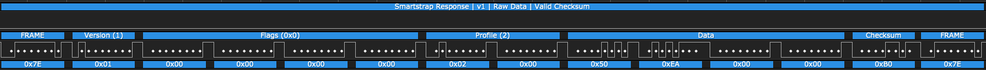

Example Frames
The images below show some example frames of the smartstrap protocol under two example conditions, including the calculated checksum. Click them to see more detail.
Raw Profile Read Request
Raw Profile Response
Invalid Frames
Frames which are too short, have invalid transparency bytes, or encounter a UART error (such as an invalid stop bit) are silently discarded.
